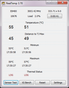

- Real Temp: monitors the temperature of your CPU and allows you to ensure it doesn’t exceed 70 degrees (indicating the CPU is at full capacity).

- Perform a stress test. It’s time to restart your computer and boot into the OS. Check the stability of your PC and keep Real Temp open to monitor the temperature.

- Check the temperature. It’s possible that you’ll reach the temperature limit before the system becomes unstable. If so, this is the limit of overclocking for your PC. As a general rule, CPU temperatures should not exceed 70 degrees.
